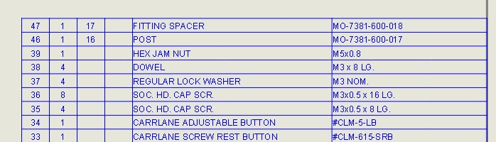

Item numbers not correct. My bi of material goes from item 39 to item 46 and skips numbers. How can I fix this?
No matter what I've tried. I can't get the item numbers to be correct. My bill of material starts at #1 and continues sequentially to #39. I added 2 new parts to the assembly and they are displaying an items 46 and 47. Why? and How can I fix this? I do not have "follow assembly order" checked. Help!!!

Has someone else worked on this Drawing?  I ask because my first thought is that there are some hidden rows.  I'd try grabbing those rows and dragging them down below 39, and then drag them back directly above it.  If there are hidden rows this should place the new rows with the correct numbers.

Thanks Glenn! I didn't know you can drag & drop lines in the BOM to re-order it (very new to SWX). Many thanks.
