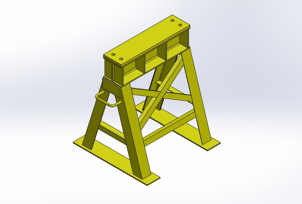

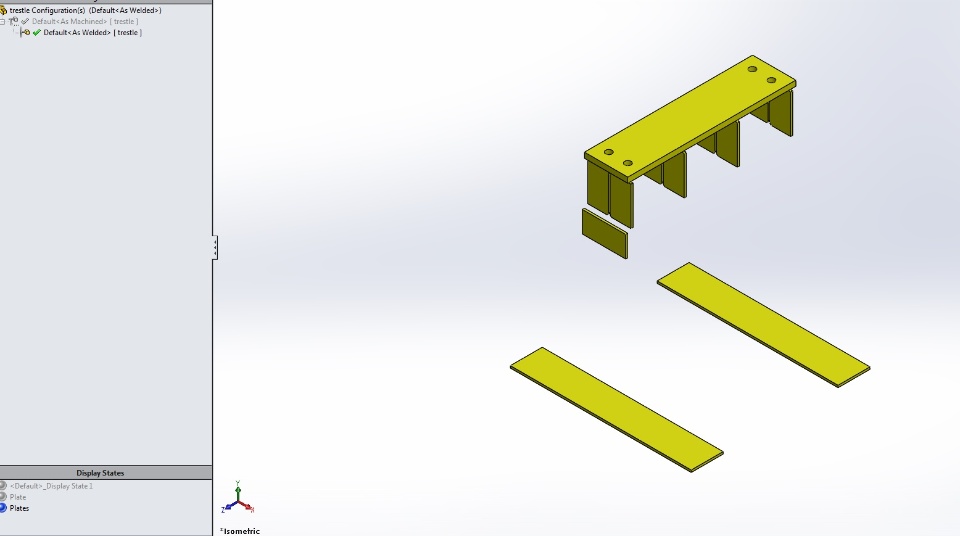

I have this weldment and I want to check the weight of just the plates. I created a display state isolating these plates but the weight remains the same as for the whole weldment. Any ideas please?

I would temporary suppress the items you don't want weighed, unless you have a lot of components.
Deselect "include hidden bodies/components", see image
Hi Ingvar,
Just tried it and it works. Thank you so much!!
