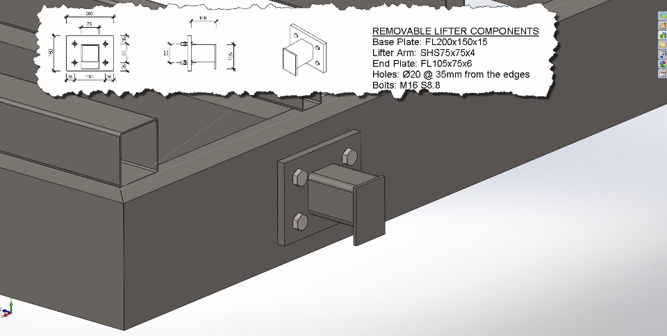

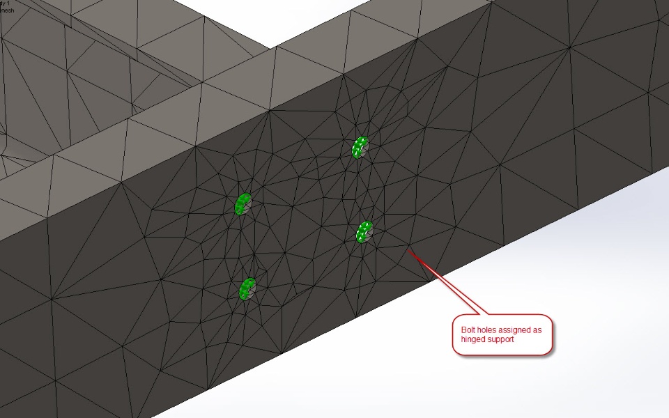

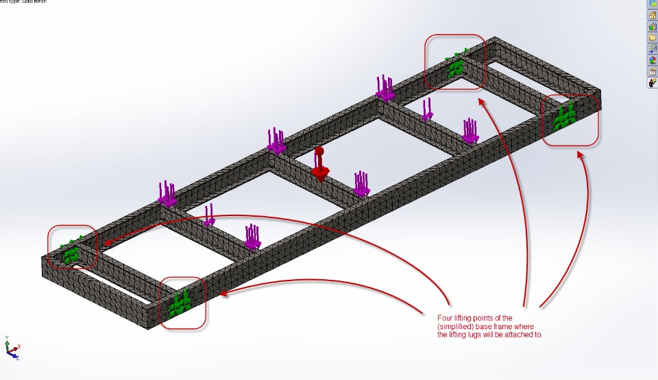

I have a base frame (I've simplified the model) which will accommodate some mechanical equipment on top and I want to simulate the deflection during the lifting stage. The base frame will be lifted from four points where a lifting lug will be bolted. I wanted to simulate the lifting operation by assigning the bolt holes as hinged support but I'm getting an error that the model is unstable. Isn't a hinge connection an immovable connection which allows only rotation?

Indeed it only allows rotation around the axis of the hole. The arrows of the fixture show the restrained movement.
Try using soft springs to detect what part of the model is unstable. It could also be a failing (bonded) connection between the different parts, due to a gap.

That is not a hinged joint.  If all those shown restraints are 'Hinges' then your model is OVER constrained.  Also, you are not going to see what I suspect you want even if you bonded a pin in the center of those four locations.  Hinged joints must be able to rotate through some small angle, usually negligible for the purposes of linear static analysis.  What you have shown can't rotate at all.  You might get closer to what you are looking for if you 'bonded' the lift lug to the frame, neglect the bolts (pretend it is welded) and get the reaction forces from each.

So basically hinged supports can be used only when to hinged points exist. Otherwise the whole structure becomes over constrain is not calculated properly. Did I understand correct?
I've solved manually at the moment due lack of time, but I will give it a try with "bonding" too.

Yes.
