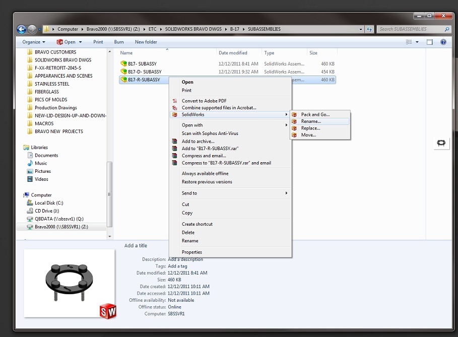

I've tried SW explorer.  It will fix the links to assemblies that reference the file being renamed, it will not catch and update any of the in-context links.
