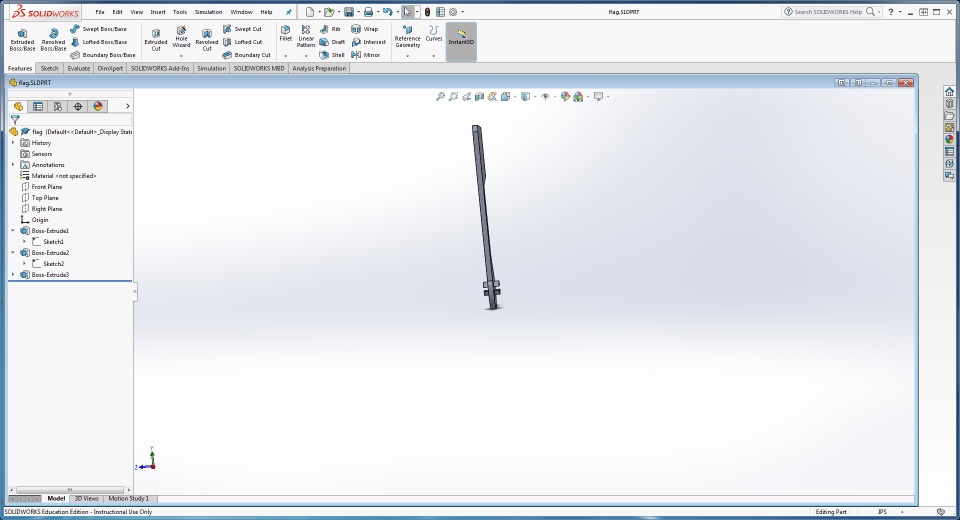

Is there a way to unlink two features?
My flag was backwards so I wanted to move boss extrude 2 to the other side. I converted the sketch to the other side. Now I can't delete boss extrude 2 without deleting them both. Can I unlink them or do I have to make the sketch again without converting?

Another way to handle this is to use the advanced features when you're deleting Boss Extrude 2.
Right click on Boss Extrude 2 and choose delete. When the confirm delete dialog box comes up click on advanced (lower right).
If the delete absorbed features and delete child features boxes are checked, uncheck them.
After you click yes you'll get an error. Just edit sketch 3, click on Display/Delete Relations and delete the dangling relations (shown in yellow)
Bingo! Boss Extrude2 is gone and Boss Extrude3 is still there!
Hope this helps.

Eric, you could also delete the OnEdge relations, then change the sketch plane, then reattach lines to edges, then extrude, it's easier than it sounds.
