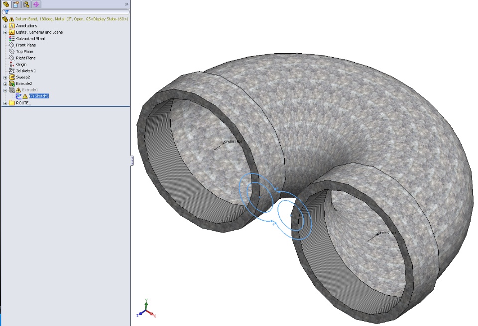

I have a part file with various configurations, and during one of the configurations a certain extrusion is suppressed because it isn't needed in that configuration.
The sketch for it gets an error message during this state, but its okay because that portion is suppressed. However, any assembly i use it in gets error messages because of a suppressed feature that becomes an error only when it is suppressed.
Is there a way to make errors suppress along with the feature?

Suppress the sketch for this configuration also.  This is assuming the sketch doesn't have any child features related to it.

In the design table I added columns for the sketches and am supressing and unsupressing them as well as the features. This worked perfectly thanks for the tip!
