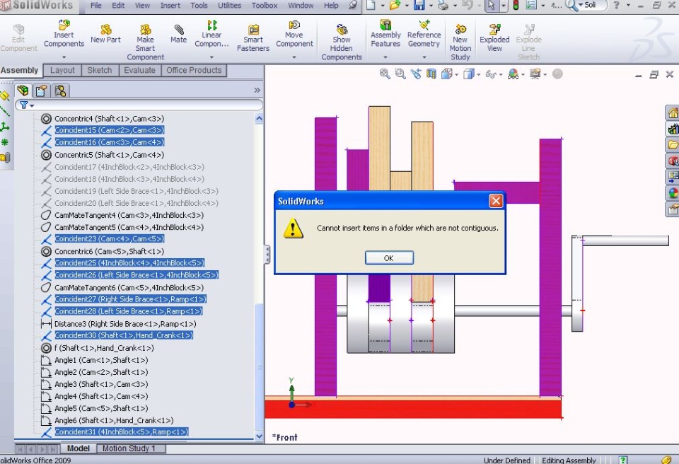

Tomasz: When I selected the mates, ie coincident, and tried to move them to a folder I got this message:
Cannot insert items in a folder which are not contiguous.
It did place the 1st four that were contiguous. And as Scott saaid I was able to manualy move the other coincident into the folder.

SF 2010-09-25
Please foregive me I,m in opposition
This is the proof
Not contiguous
Contiguous
Add to new folder
Message was edited by: Tomasz Wroblewski
comment imagecomment imagecomment imagecomment imagecomment imagecomment image
