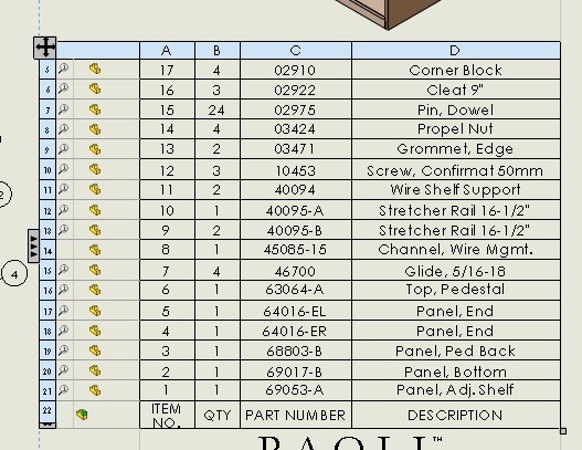

Yes, as Andy said, it is very simple and still there in SW2010.  Just move the cursor to the left edge of the BOM table and you will see some small arrows at the edge, click that and it expands out. Every item that has a balloon will show a balloon symbol. See my screen capture below. You'll notice all items except item 8 has the balloon symbol, this indicates that item 8 still needs a baloon, all others are ok.
Hope this helps,
Steve
