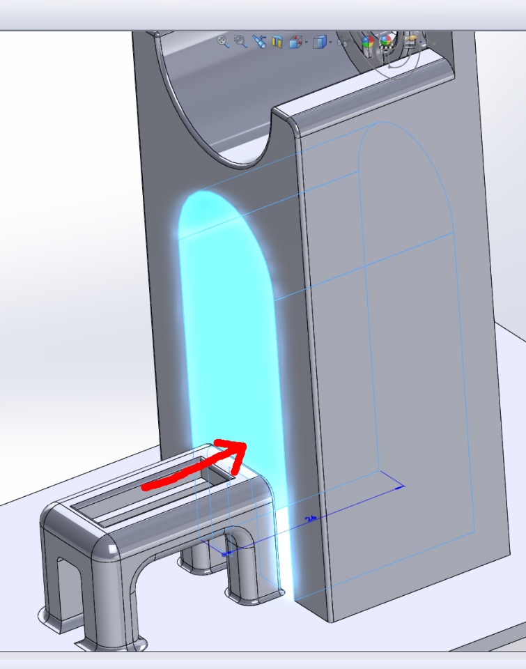

Is there a way to move a feature into another feature that has an extrude going through it?
I want to move the little stand into the glowing arch just a little bit, but the extrude eats it all up as I try to move it in.

If your cut is after another, it will eat it up. It works as is in a timeline. Whatever you do at last effects all before. But, if you are working with multi bodies, you can select your feature to be applied to a specific body
You need to drag and move it to upper position in feature manager. If you are not able to do so, it is depended on another feature before itself and moving it will become a paradox and not possible. Not exactly but this is like installing Solidworks before Windows.

Can you just re-order the stand features after the arch cut?
