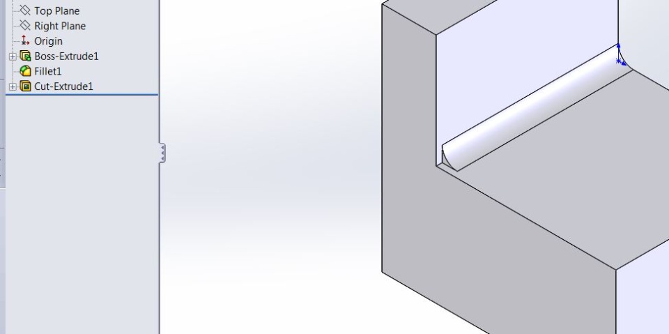

Is there a way to make an edge fillet that does not do the entire edge?

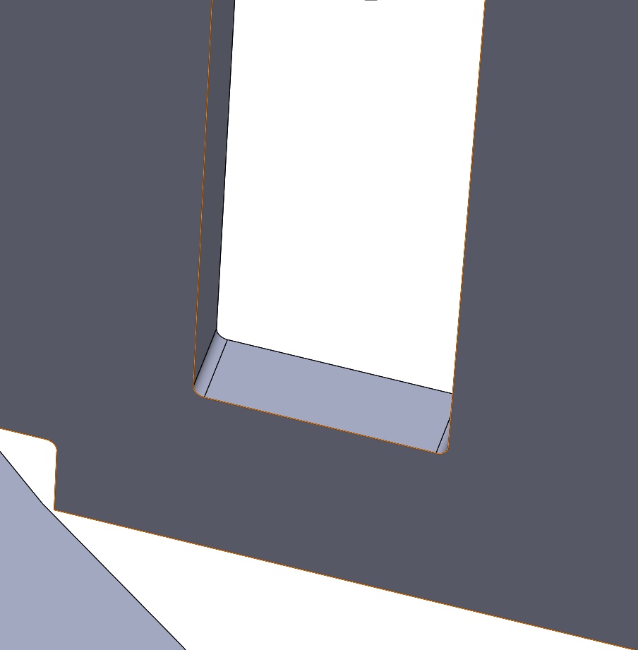

I need an easy way to fillet an inside corner edge less than the full length of the edge.  Is there a way to do this in SW 2013?  My molder asked for a 0.2mm setback from the end for their tool.  I thought this would be an easy change or redo, but with drafted surfaces I can't just cut the existing fillet back, and it doesn't look like I can just do a "distance from edge/vertex" in the fillet feature.  Images attached for refernce.
Hopefully I'm missing something or there is an easy workaround.  I don't do a lot of plastic parts, so would love the help!

There isn't an easy way that I know of.  Best idea I have is to fillet the whole edge then add material back into the area.

Thanks for replying Randy.  I'd actually like to remove 0.2mm of material of the fillet (if I did the whole edge first), not add any.  Sorry if that wasn't clear.

Several ways/workarounds:
1. You can extrude the fillet profile and keep off 0.2 from surface.
2. Split the face and add fillet.

If the draft on the two walls is the same, you can make a drafted cut.
You do realize that this will leave you with a stress concentration at the corner? If you need the fillet to reduce the stress, this could be a real problem.
I'm not sure why the mold maker would want to stop the fillet before the "natural" stop point.

Depends on the shape of the body that you are filleting. If it is a fairly simple shape split where you want fillet to go, to then appy fillet, then join 2 bodys back into one.
I have used this method a few times to do exactly what you are asking.

Can't you just add the fillet along the whole edge and then create a sketch using the fillet edge and a horizontal & vertical line and do a extruded cut?
