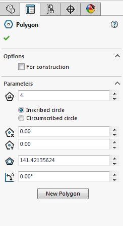

Is there a way to draw a polygon without an inscribed or circumscribed circle?
The title mainly says it all, but I really wanted to ask:
Is it possible for me to draw any polygon without inscribing or circumscribing a circle in the process?
I am using SW 2016, and I don't see how I can achieve this.
I don't see a "no circle" option...
Thank you so much

..so, you mean, a option to not include the circle entity constraining the poly in/out,.. why not just break/delete the circle link,.. it's two clicks.
Why is having a circle a issue?
GS
GS 2021-04-09
Insert the polygon with the circle, then delete the circle and define the polygon with dimensions and relations.
