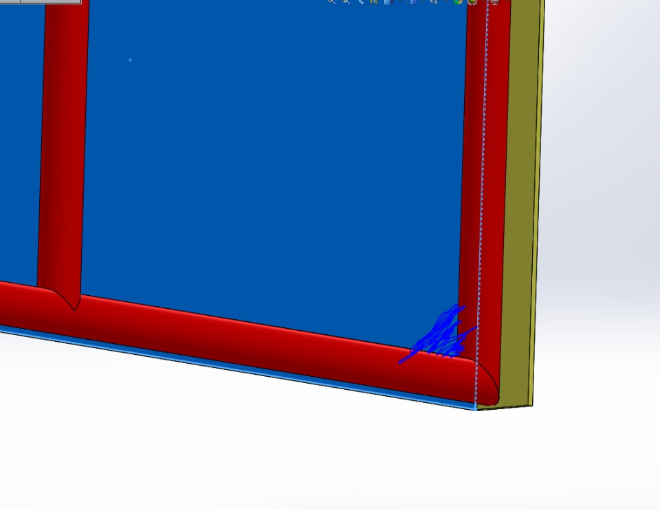

Is there a way to add a gusset to a pipe weldment?
I need to put a gusset in a weldment, but I can't for the life of me figure out how to do it.  I'm still relatively new to SolidWorks, and really new to sheet metal work, so I know I'm probably overlooking something simple.  Can someone please point me in the right direction?

Offset a plane to the center of the pipe, then create the gusset as an extruded boss.

I'm assuming you used the Structural Shape function to create the pipe.  If so, I'd suggest doing what I've done.  I have a folder in my weldment profiles named "Plate", with various plate and strap profiles.  Then when you need strap in a weldment model you can use these profiles and they will fill in the cut-list with Length, Material, etc.
