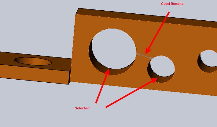

The problem is that when the two cylindrical surfaces are parallel the result is not the shortest distance but rather between the two center lines:
According to the literature, to resolve this issue with two parallel cylinders the following code was added:
nDist = swModel.ClosestDistance(swFace1, swFace2, vPoint1, vPoint2)  'Gets Center Point
If swSurf1.IsCylinder Then    'Measure has returned the center point, so use the point on the other surface
   vClosestPt1 = swFace1.GetClosestPointOn(vPoint2(0), vPoint2(1), vPoint2(2)) 'Fails here in assembly
Else  'Probably on the surface, but just to be sure...
   vClosestPt1 = swFace1.GetClosestPointOn(vPoint1(0), vPoint1(1), vPoint1(2))

Within a "part" file the results are good:
However within an "assembly" the results are wrong (shown below).  All of the code that is working in the previous examples is the same.  Below is the result when the points are translated.  Sadly, the results are not much better if the end points of the temporary line are translated or not.
It is expected that for a part, the result should be good without translation and for an assembly the result should be good with translation.  However, in this one case, neither result is good.
Any idea what the problem is?  One possibility is that perhaps the GetClosestPointOn returns the point values that are already in the Assembly Coordinate system?
Has anyone else ran into this?  Is this a problem within the API?  Any ideas about how to correct this last case?
