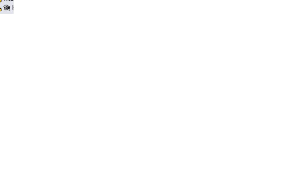

is there a glossary of icons in solidworks? and what does this one mean?
Hi, obviously search has failed.   It's easy to search on a word to look it up, but not so easy for an icon.
So, is there a list of icons with defintions about what they mean in solidworks?
And, what does this particular one mean?  (Sort of hat like you get at graduation in college)

LB 2011-12-20 Best Answer
it means the file was made in either a student or educational version....Graduation Cap!
Which means you are to use for commercal or work related, read ELU.

OK, that answers that.
But is there a general directory/glossary of icons?
SF
SF 2011-12-20
I was unable to find one when I felt the same need as you have.
With time, and lots of right clicks and mouseovers, I got over it.
It is part of the love hate relationship with SW.

Hi Bryan,
There is no one glossary of icons because there are literally thousands of icons in SolidWorks so having them all in one location would make it difficult to find what you are looking for. Most of the icon definitions are spread thought the content of the help and defined in mini glossaries in the context in which the icons are used. For the FeatureManager icons, you can find most of the definitions of them if you do a search for "FeatureManager icons" in the help and then click through the resulting pages in the search results:
http://help.solidworks.com/Search.aspx?query=FeatureManager%20icons&version=2012&lang=English&prod=SolidWorks
I couldn't actually find this particular icon in the help at all, which is strange because I thought it was documented. I'll make sure our documentation department knows about it so they can be sure it is documented.
Thanks,
Jim
