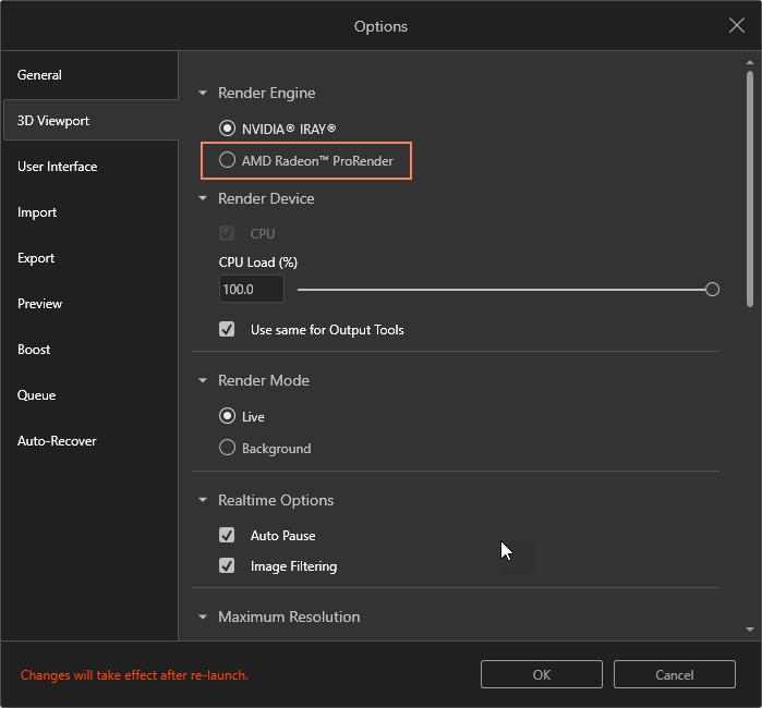

Is the AMD ProRender active in Visualize?
I noticed that the AMD Radeon ProRender Engine option is in the settings , does this actually do anything as of this moment? or is this slated for a later beta?
I saw the demo of this at SWW and it looks pretty good and would love to give it a rip on our Pro WX card to see the comparatives to Nvidia.

Hi Scott,
The AMD ProRender is active in Beta 1.
You can access and switch the Render Engine from NVIDIA IRAY to the AMD Radeon ProRender at any time without having to relaunch the Visualize application.

Hi Scott.
Sorry...  What I meant was that "today" (as in Visualize 2019) if you have an AMD GPU then you will be running Visualize in CPU only mode. ProRender was added to help this set of users...
So YES...  With Visualize 2020, you now have the option to utilize that AMD GPU with ProRender.

Hi Ron ,
could you clarify that a bit , are you saying that the Pro render setting does not use the GPU of the AMD card??
if this is the case then what are the advantages of ProRender vs just using an AMD card on CPU only mode?
When I saw this at SWW it looked like it was very comparable to iRay, is this different than what they were demoing at the AMD booth?

Correction!!!  You do have to re-launch
Also, bear in mind, this is not in the software as an intention to compare with iRay.  The intent is to provide users of AMD GPU's with a better experience.  Today, if you have an AMD GPU, then Visualize falls back to CPU only mode.  So the fair comparison is ProRender VS iRay CPU mode.
