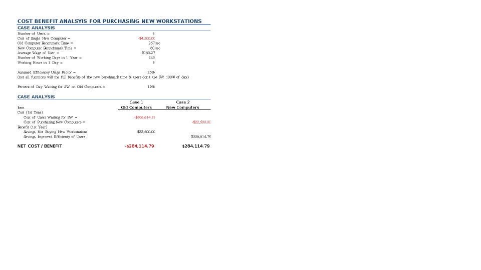

How many users do you have?  I went through the battle to get new workstations a year ago with management.  We ended up buying a test machine and I ran tests to judge the potential performance increase.  We saw a huge performance increase on the test machine (simulations went from 1+ hr to less than 5 minutes in one test)
If you can show how much time you can save by getting new workstations you may be able to convince management to shell out the cash.  I used the attached spreadsheet to calculate the cost of not buying new computers.  Good luck!

        Thank you for the spreadsheet. I am going through the same thing, trying to justify 10 new computers with 1 GB to 2 GB cards. I keep telling them I am waiting 40 percent of the time on the computer when I work on my main assemblies.
