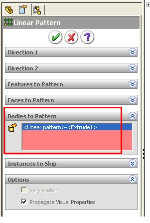

I am trying to do a Linear Pattern
I will put some pics up tomorrow
It doesn't give me the option to selct the derived part
Thanks for the help
DG
DG 2012-03-19
Just click under the bodies to pattern and then click on the derived part.
