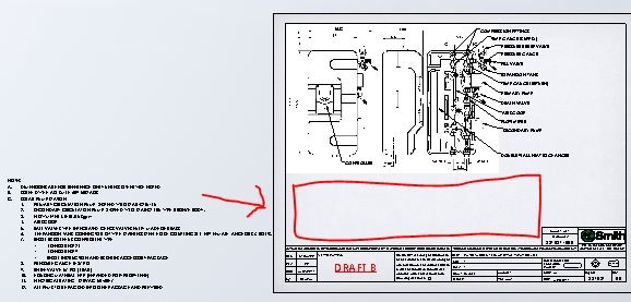

Deepak,
I'm just trying to fit some notes in the remaining space on my drawing without having to go up a sheet size. (see attached)

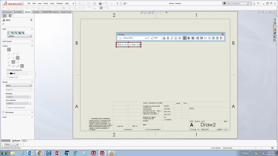

GS
GS 2019-04-30
<p>Scott McFadden wrote:</p><p></p><p>If there is a way, looking through the properties of the note or in the note manager, I am not seeing anything glaring at me that would allow this to happen.</p>
It may not be glaring, but it can be done, and isn't difficult.

GS
GS 2019-04-30
<p>Britt Kessler wrote:</p><p></p><p><strong style="text-decoration: underline; ">The original poster asked for a way to create two columns of notes, not two lines.</strong></p><p style="min-height: 8pt; padding: 0px;"></p><p><a _jive_internal="true" data-containerid="-1" data-containertype="-1" data-objectid="36944" data-objecttype="3" href="https://forum.solidworks.com/people/1-NVO49A" data-community-id="1">Glenn Schroeder</a> I'd like to know if you just spaced out those two columns, or if there is an actual command within the Notes annotation menu that allows you to create the two columns within the note field. (Not talking about inserting a table) I've looked, and haven't found it...which is why for any block of notes larger than five or six lines, we insert a MS Word document to allow more options on text formatting.</p><p style="min-height: 8pt; padding: 0px;"></p><p>We have SWX 2016, and I'd be interested to know if SolidWorks has added any kind of enhancement to the Note / annotation commands in recent years.</p>
That is two columns. And you said "Not talking about inserting a table". Why not, if it can accomplish the same result?
comment imagecomment image
