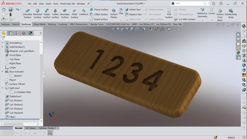

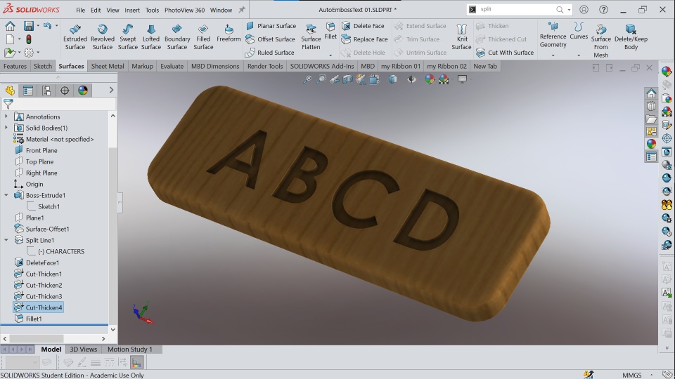

Is it possible to automate the process of creating embossed text on a solid?
[please find attached my SLDPRT file at the bottom]
I'd like to go from image-1 to image-2 (see below) in one step. Meaning I'd just like to change the text in some text-box, then click re-build and be done. Is this possible?
Edit: Just to further clarify, I'm not interested in embossing just ABCD and 1234. I'd like to be able to input any combination of four alphanumeric characters.

You can add a sketch and use the text feature and use a Custom Property, then in your Custom Property Tab Builder you can type in the numbers or letters you need in the sketch

I decided to test the limits of the wrap tool. So I'll just park these pix here for anyone else who might be curious.
comment imagecomment imagecomment imagecomment image
LG
LG 2021-03-26
Well, this is embarrassing . Looks like I have fallen victim, yet again, to watching the 'most viewed' youtube tutorials instead of the 'most recent', or at least filtered to show only those tutorials from the last 12 months.
And so, to answer my own question with only two words ' WRAP FEATURE ' . . . basically, there's no longer any need for offset-surfaces or converting text to split-lines. Just use the wrap feature/tool. Easy peasy.
Also, I got my terminology wrong, all my examples show 'debossed' text and not embossed
[New SLDPRT attached]
