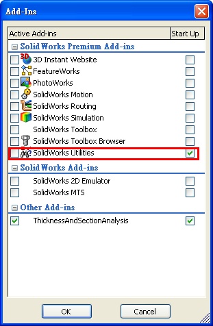

Is it possible to active "SolidWorks Utilities" By API?
I wrote C# Add-in using the function "RunThinAnalysis2" of  "SolidWorks Utilites"
gtcocswUtilities swUtil = (gtcocswUtilities)this.theiSwApp.GetAddInObject("Utilities.UtilitiesApp");
if (swUtil != null)
                        gtcocswThicknessAnalysis swThicknessAnalysis = swUtil.ThicknessAnalysis;
                        int status = swThicknessAnalysis.Init();
                        int errorValue = swThicknessAnalysis.RunThinAnalysis2(minValue / 1000.0,
                                                                (int)gttckResolutionOptions_e.gttckHighResolution,
                                                                (int)gtResultOptions_e.gtResultSaveReport,
                                                                pathFolderThickness,
                                                                true,
                                                                true,
                                                                true);
This add-in is built up as a dll file, and it works well in SolidWorks
Now, there is a  new issues that I need to use another standalone program to wake up Solidworks and this addin
string SwLoaderPath =  ".\\\\sldutils\\\\SwLoaderSw.dll";
string addinLocation = System.Windows.Forms.Application.StartupPath + "\\\\ThicknessAndSectionAnalysis.dll";
long result2 = swApp.LoadAddIn(SwLoaderPath);
long result1 = swApp.LoadAddIn(addinLocation);
But every time when Solidworks is waken up,the "SolidWorks Utilities"  is not  active, and I have to turn on this option manually before using my Addin.
Is there any method to active  "SolidWorks Utilities"  using C# Solidworks API?
