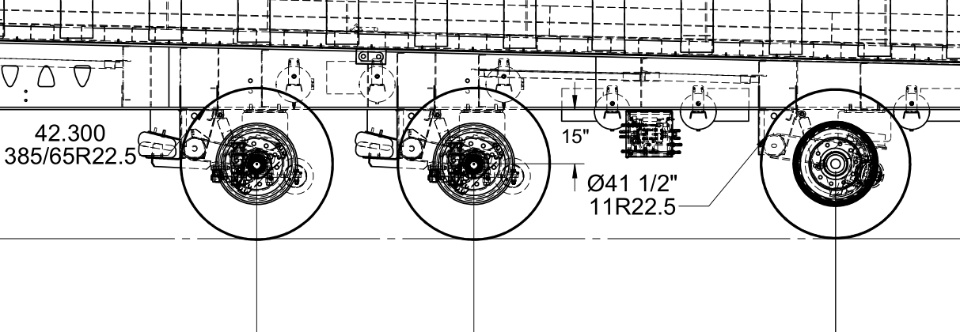

Is it possible for an annotation's leader to follow the centerpoint of an arc
As the title says, is it possible for an annotation's(or balloon's) leader to follow the centerpoint of an arc? The reason I ask is that we use annotations to call-out properties on specific components such as wheels of our trailers and when you attach the leader, it looks ''wrong'' to not have it pointing centered.
Same thing applies to the leader of a balloon. Why does it not follow the center of an arc, like a diameter dimension or radius dimension? It would avoid having ''bad practices'' such as this:

...is it possible for an annotation's(or balloon's) leader to follow the centerpoint of an arc?
Not yet.
https://r1132100503382-eu1-3dswym.3dexperience.3ds.com/#community:h6OPd8sKT4u_n1j65oVt7A/idea:qOJQw50CRAaYuIC6G_NP4A

you are correct that is a flag. therefore, i think ‌'s workaround of grouping a balloon or call-out to a dimension is the best option. that way they will update automatically.
AL
AL 2021-04-08
That's a flag, not a balloon to indicate the part number from the BOM, unless I'm mistaken.
‌ I don't need or want a dimension. Adding one and then hiding it could be a work-around for now but it's just as manual as every other ideas I've come up with.
If dimensions can follow centerpoints, annotations should also. At least make it an option!

You can group a balloon with a dimension (which will mean that the balloon will "follow" the dimension as if it is part of it.
DE
DE 2021-04-08
you actually can put a balloon in a dimension.
comment imagecomment image
AL
AL 2021-04-08
Doesn't really work with my workflow. It would be more impairing then having to manually place them as we are actually doing.
Besides, I doubt you can do balloons with a dimension, or call-out properties from a dimension.

Dan Eldred wrote:
it may not be optimal but you can fake it by replacing the text in a diameter or radius dimension.
That''s true, but it doesn't work if you're linking the notes to Part properties, which Alex says he's doing.
DP
DP 2021-04-08
Or grouping the actual annotation with a radial/diametrical dimension that has its all of its text removed.
DE
DE 2021-04-08
