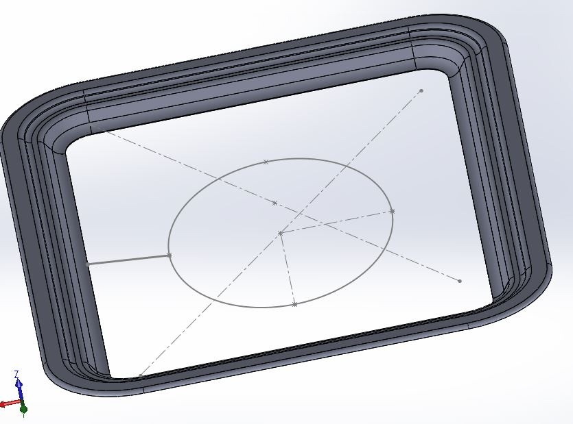

Is a swept boss the best selection to use when trying to create a slight angle in the bottom of a rectangular pan that has a hole in the center
I have a rectangular pan that has a hole in the center.  The hole is lower than the edges.  I am trying to use a swept boss to create a solidbe tween the edges of the pan and the center hole.  I have a cross section I am trying to swept but no luck.
Is the swept boss the best when to do this?

You might need to use a loft feature. If you need the entire part to be uniform thickness then consider modeling either the inside or the outside of the entire part with surfaces first, then use the thicken command.

Can you attach a *.sldprt file rather than an image file?
SF
SF 2014-08-13
I'v e attached the part that I am working with. It's "sweep9" that iIm trying to resolve
JS
JS 2014-08-13
Here's how I would do it with surfaces, loft, and then thicken.
