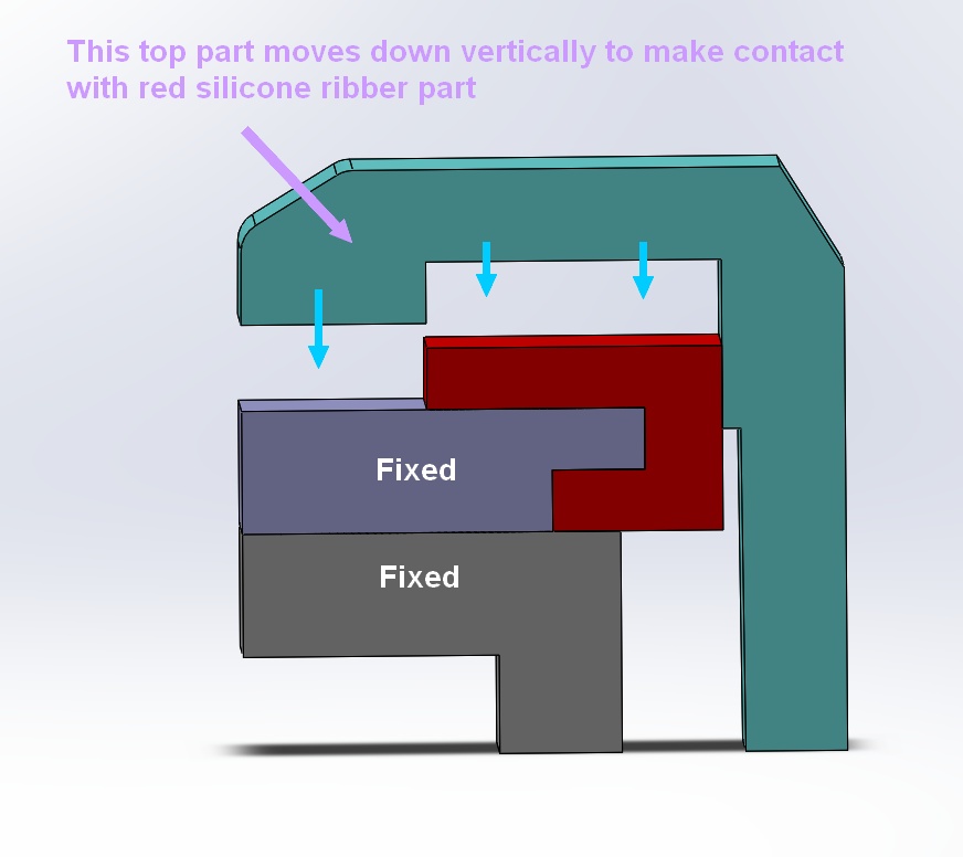

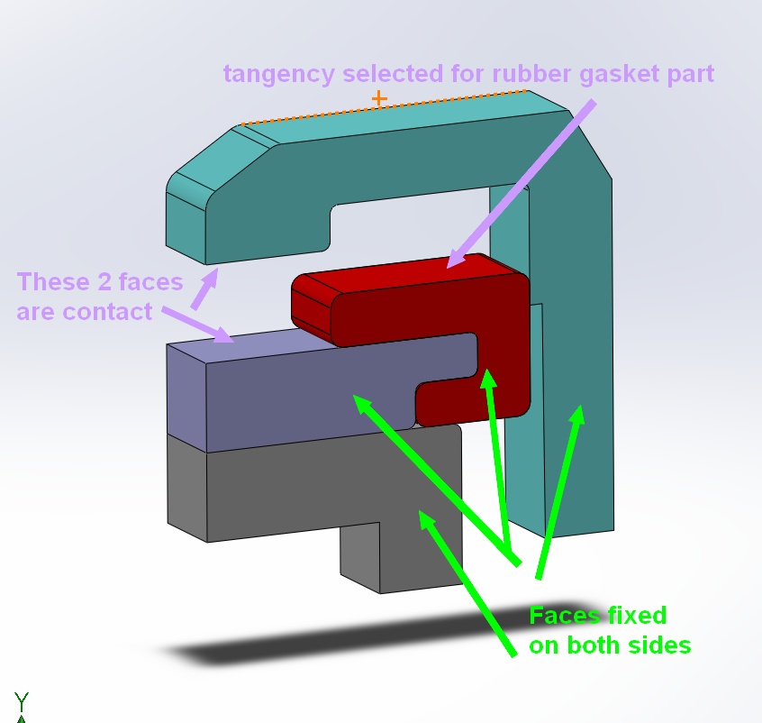

I am attempting to do a nonlinear model of a silicone rubber gasket between two polycarbonate parts. I have used the Tutorial, Nonlinear Contact Analysis of an O-Ring, for guidance as it is very similar. The difference is that the silicone gasket is a U-shape and there is an open space. I am hoping if someone can tell me if I am wasting my time or if it is possible?  I have attached the parts and assembly below.
the final position should be like this.

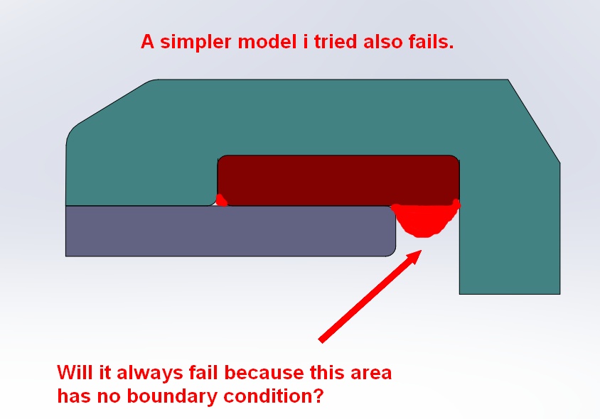

I have tried to make it simpler to start with but I am unsure if the it wot work due to the open area.

There's no theoretical reason for it to not work.
I haven't used sw NL a lot, can you choose to do this 2D?
However the shapes look like they will lend themselves to some numerical issues, like when the wall on the left pinches down on the rubber - you will need to use much smaller stepping than in the tutorial I would guess.

The issue that SOLIDWORKS Simulation Premium has is that it does not have the capability of remeshing a nonlinear analysis if the elements become too distorted as they deform under load like the higher end more expensive software can.

Definitely possible, as noted. I will share some general advice - on a new (to you) class of problem start simple and add complexity one step at a time. This problem could be done with linear materials first.

2D is better since it uses fewer elements to solve.
Just Make sure you have the right curves for your rubber properties.

Thanks Steven. I got it to work. Yes, I used 2D at first, it modelled perfectly as expected. Then i applied the same study parameters to 3D model. It was great using 2D as it modelled quickly and was less complex so i could quickly see the issues and adjust until i got it correct.
