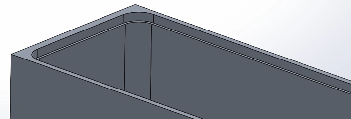

Hello everyone,
I'm trying to create an inward-facing edge instead of an outward-facing edge like in the photo, I want  the reverse of this. I can't figure out how. When I sketch this area with the offset, I end up with a solid face, even though what I want is just the outline that I would like to emboss. Could someone help me or guide me? (Thanks)

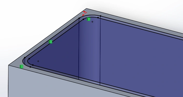

Somehow, I would like exactly that, but going downward :

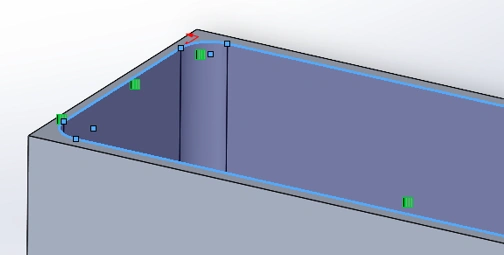

I did it with Extruded Boss with 2 directions and using 0.01 as main direction, but that leave me with a 0.01 border (since I cannot set it to zero) :

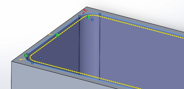

Grrrrrr juste found out that this is a button and that serve to reverse en Boss-Extrude direction...  Sorry, just a beginner...  THIS is the solution, but thank !
