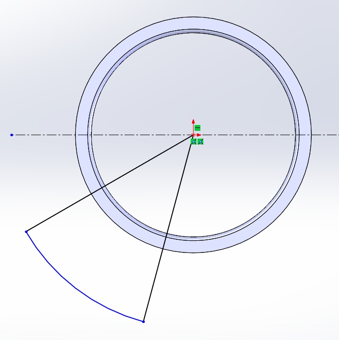

A colleague has had this issue since install of SW2016 SP3.0 (I believe - maybe just coincidence) and between us, cannot resolve it.
None of the dimensions are visible and double clicking any of the sketch elements pops up an edit angle value box.

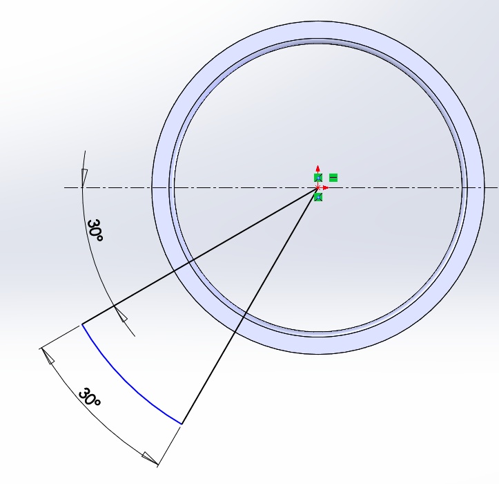

However, the same file on my PC looks like this when editing the sketch.
Has anybody come across this and is there a setting that has been inadvertently selected to make the sketch act in this way ?

Thanks for the responses but it seems that it was none of the above.
On opening of other sketches in other parts there was a whole host of other anomalies including infinite dimension leaders.
This pointed to a system error rather than a setting issue and a repair has now resolved the problem.
