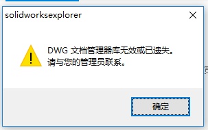

This appears to be a Workgroup PDM or SolidWorks Explorer question. The SolidWorks PDM/EPDM forum is probably not the best place to get a response.
If you are attempting to use SolidWorks Explorer with SW PDM you should not do that. SWPDM uses Windows Explorer or the SolidWorks Add-in. SW Explorer was created for use with WGPDM.
