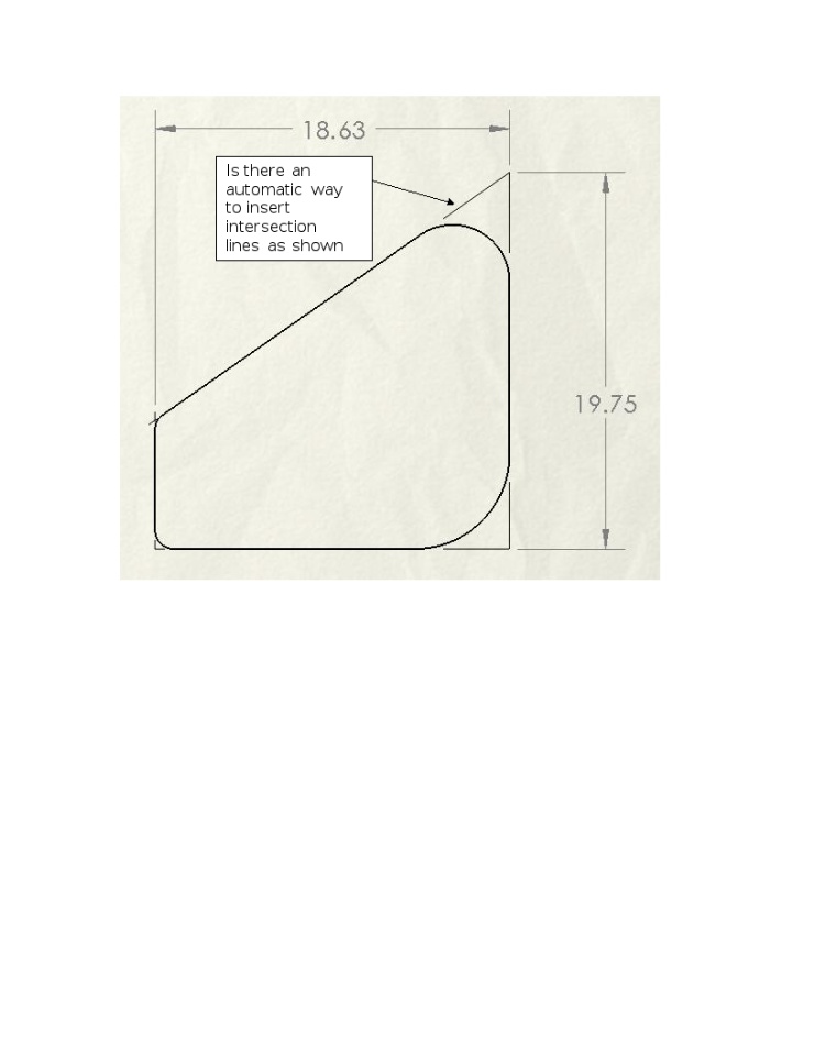

Hello,
Is there an intersection symbol built into Soildworks drafting.  I've used several other CAD packages that have these and they are very handy for dimensioning radiused corners.  I can create them manually using sketches but this is painful and time consuming.  Please see the attachment for picture of what I want.  Thank you all very much
Kyle

SR 2009-12-11 Best Answer
Kyle -
Lookie up "Virtual Sharp" in Help
