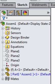

  3. Create a new internal component.  You can use one of the primary planes in the assembly for the initial sketch plane.
  4. Sketch some geometry

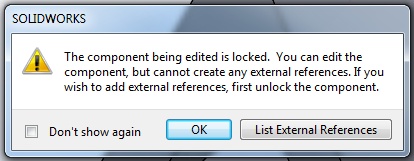

  5. Attempt to make a relation between the sketch geometry and the previously inserted component. You will see something like the following message:
If you click OK the message will appear again.  If you click OK once more, the relation will be applied (but with the ->?) marker and the same error message will appear two more times.

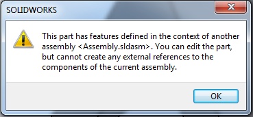

If you then click anywhere in the viewport you will get an error like this:
Note the name of the file in angle brackets.  This is not the name of the unsaved assembly file.  The unsaved assembly file is Assem1.sldasm:
The ‘Assembly’ seems to be coming from the document template Assembly.asmdot, which is our default assembly template.
