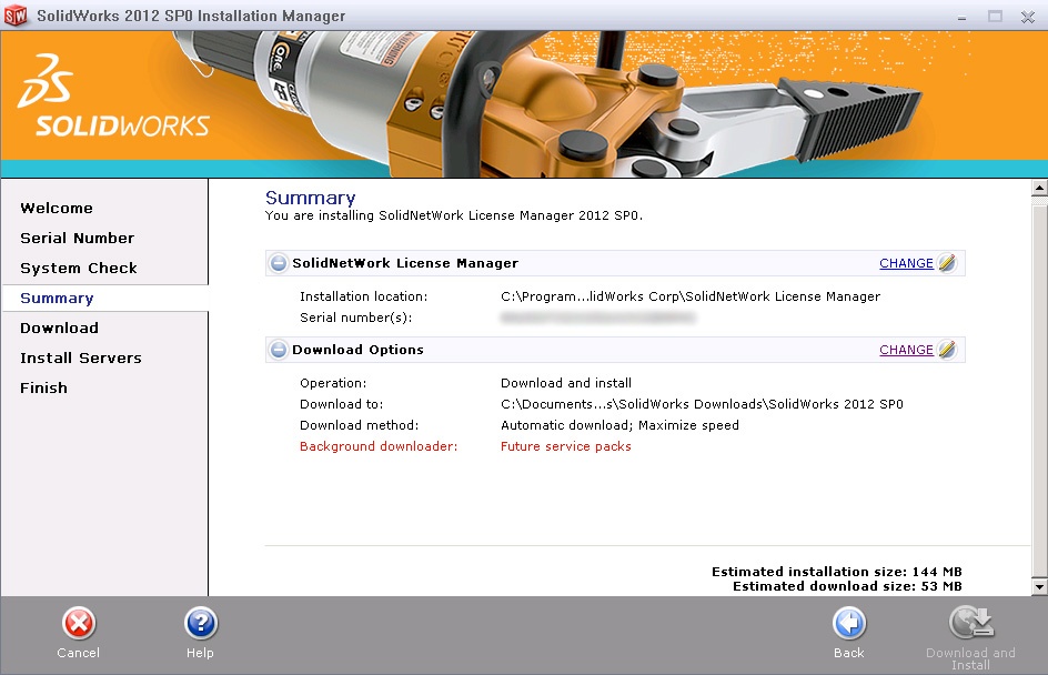

I'm attempting an install of SolidNetWork License Manager (through the installation file I downloaded from the Solidworks website), and I'm getting stuck right away. When I get to the Summary of installation options, I'm unable to actually click "Download and Install", the button is greyed out.
Attached is a screenshot of what I get. What needs to be modified to go forward?
I'm sure this is a simple issue, but any help is greatly appreciated!
My operating system is Server 2003, and I've already got 2011 installed fine on the server.

SF 2011-11-07 Best Answer
I had a bit of a different problem with the License Manager, but the solution may be the same.  Try downloading the License Manager files themselves and run that file to install rather than the Installation Manager.
