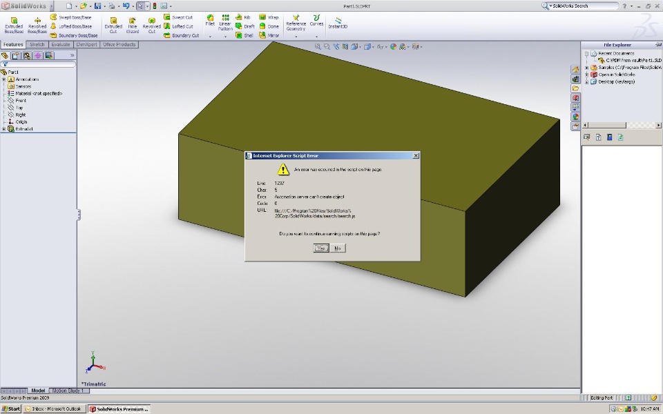

I recentlyposted a issue where I could not run solidworks at all after upgrading to SP40 fro 30. 2009.
It would starrt the splash screen but never run. I removed it completey and installed 2009 sp0. It runs now, as I want to see  if it runs before I try to upgrade to SP4.0. So far close. I get the following error when I run the program. It works but the error is effecting a few items.
One - Explorer cannot load a "view" of a model. Says it has trouble getting it from vault. I also see the same error in explorer when it starts. Most likely a XP issue, I just need clue to where to fix it. Anyone know what this means. IN the meantime, I am going to try to load sp4.0 and see if the program will run this time.

UPDATE
We (Value Added Reseller and myself) have found the issue. It has to do with the driver for graphics card. Nvidia Quadro FX1300.
The bad news is this graphics card is not listed as "supported" in 2009 at all. We updated to the 2008 driver and we are at least working now. Lost 3 weeks of workstation use farting around with XP checking etc.
What concerns me is this issue itself. And the fact it is not listed for 2009. What would happen in 2010 release. The hard truth is my workstation although 4 years old cost my company over $6000 and seems to becoming obsolete for solidworks. It is a DELL Precision 670 loaded. The program (solidworks)  seems to be going the Pro-E path of difficulty with hardware, loading software etc.
That is a real sad situation. I am working now. But concerned.
