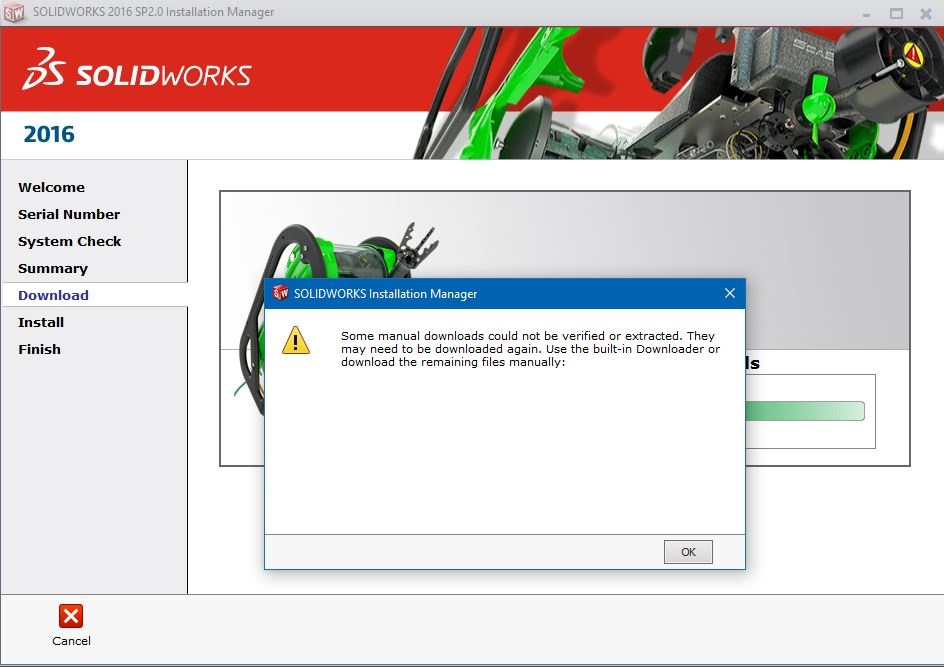

I am trying to download Solidworks 2016 on my PC (windows 10 Home)
First I tried to download it automatically but I had some problem with that, then I chose to download it manually and I did
I download all this list on the location asked, and after I finished I returned to the Installation manager to install solidworks and run into this problem
"Some manual downloads could not be verified or extracted. They may need to be downloaded again. Use the built-in Downloader or download the remaining files manually:"
I am sure that I downloaded all the files!
can someone help me with this issue please?

DL 2017-08-29 Best Answer
From the looks of the installation window you're actually downloading the SW files to your OneDrive account. You need to download to your actual hard drive or SW will not work correctly.
