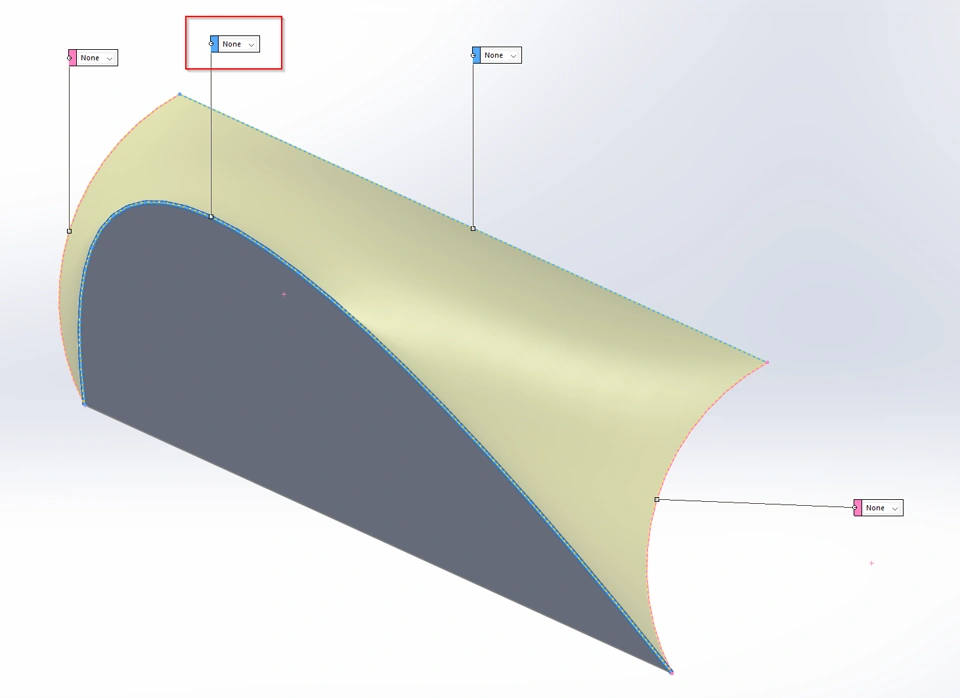

I can specify tangency for a Boundary Surface feature through the GUI, but not through the API (SW 2023). The macro below creates a Boundary Surface feature using an edge and a sketch in direction 1, and two sketches in direction 2. I use SetNetBlendCurveData to specify that the surface should be tangent to the adjacent surface at the edge, but it does not do anything. The tangency condition shows as "None" in the feature editor.
Am I doing something wrong?

' 3rd argument of SetNetBlendCurveData is TangentType. 3 corresponds to swTangencyType_e.swTangencyAllFaces
Set myFeature = Part.FeatureManager.SetNetBlendCurveData(0, 0, 3, 0, 1, True)

Set myFeature = Part.FeatureManager.InsertNetBlend2(2, 2, 2, False, 0.0001, False, True, True, True, False, -1, -1, False, -1, False, False, -1, False, -1, True, False)
