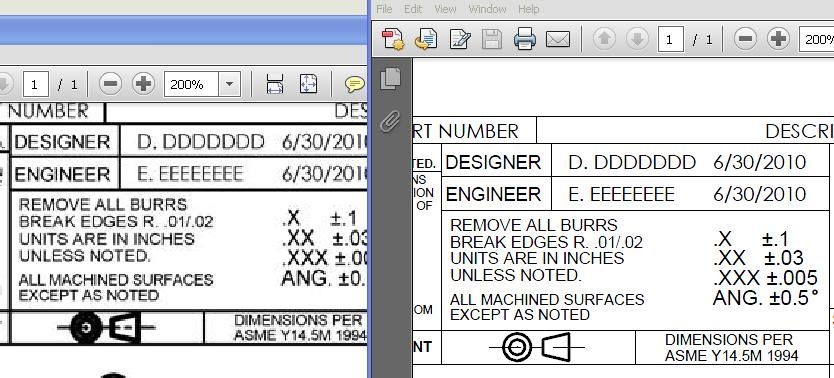

I have inserted a jpeg into to a drawing but noticed that, when I print it to my pdf printer, I get blurry text in the print frame.  I have tried different formats (BMP, GIF, PNG) but always the same result.  I have removed the image and the text returns to sharp and clear.

I added a jpg to a blank drawing (the vendor wouldn't only provide a pdf of their drawing so I cropped out the portion I wanted to include on our drawing) (I didn't include any of their image on my attachment cause I don't want any hint that I violated their NDA, but it's just a black and white line drawing of a part).
When I did that and printed the SolidWorks drawing to a pdf, the text in the print frame looked blurry (See left side of attached image).  If I remove the jpg, I get nice clear text (right side of attached image).  The text isn't part of the jpg, it's part of our standard sheet format so scaling isn't the issue.
I've tried adding the jpg in various formats but I always get the same result.
I don't think it should be a graphics driver problem as this it is blurry on the print out as well.
Thanks.

SF 2012-06-15
See if you have High Quality checkbox checked in the print dialog.  If so try unchecking that to see what happens.

JD 2012-06-18
Thanks.  Unchecking High Quality is counter-intuitive but it worked perfectly.
