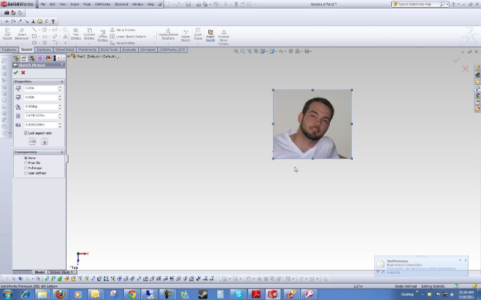

inserting a picture
Trying to insert a picture and it tells me error reading file?
It is saved as a .tif
Tried to bring it in a open sketch also with no luck.
Thanks

SF 2011-05-16 Best Answer
You might try opening the imgae in another program and saving it in a different format jpg bmp.  I have run into this before when inserting tiff images as sketch pictures.  Im not a graphics person but I think it is related to tiff compression.

To insert the sketch picture are you using: Tools>Sketch Tools>Sketch Picture?

that was it I was going to insert picture.
What does that do then???

Try using Insert>object then browse to where your picture is.
I have used this method before and it does work.

If your image is in CMYK format you'll recieve this error.  be sure your image is in RGB.

<p>Brian Place wrote:</p><p></p><p>that was it I was going to insert picture.</p><p>What does that do then???</p>
That inserts a static image as a background.

here is an example of inserting a sketch picture
