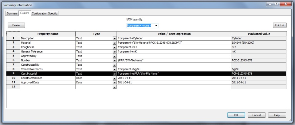

Hi again,
I've got a bit on the way but still not all the way.
I've made a custom property "Cast material" which will be assigend all new part the filename.
When I insert the new part I import all the custom properties.
I've made a custom proprety tab with radio buttons where I can choose what kind of product it is.
These radio buttons are linked to the custom propety Material. When chosing Casting or Machined Part it will assign the SW-Material to this property.
When chosing Machined Casting it will assign Cast material to Material.
When I do the 2D drawing the Casting and Machined Part drawing works fine but for the Machined Casting something happens.
All other properties works fine (description, roughness et.c) but material doesn't.
Does someone have any idea why?
Thanks!

I am not sure where the  "from parent" prefix comes from, but you should let the tab
builder drive everything.  After I have my tab builder setup I rarely if ever go back to the
file>properties dialog.
I personally think there are too many material properties.  There should be one.  SW-Material
in the tab builder call out and have that drive both the casting and machining print.
If anything have a seperate line item or category setup in your material file strictly
for the machining operation.  This way you have one part template that drives both operations.
I hope this makes sense.

I believe that instead of the property cast material, it should be the file name property of the cast part.
Scott,
When you insert part into part, then you have the option to import custom properties too. So if a property gets inserted, "fromparent+" get automatically tagged as prefix for that property.
