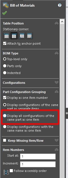

Insert a BOM with option "configurations of the same part as one item"
Hello,
I'm trying to insert a BOM into a drawing with the option of merging the configuration of the same part as one.
Thanks to a previous threads, I managed to copy the macro and it worked, except for merging the configurations.
here is the macro that i found:

The Question is:
How I can implement what's in this link into my macro?
2019 SOLIDWORKS API Help - swPartConfigurationGroupingOption_e Enumeration
Thanks you for any help.
