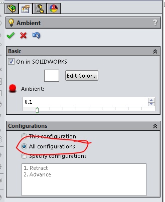

Where I work, the projectors in conference rooms don't show our SolidWorks assemblies very well.  The brightness just isn't there.  If I turn it up on the projector for SolidWorks, all of the other applications are washed out.  One of the people here wrote a macro that will increase the ambient light in the assembly just for when we are in a conference room.  It works great.  The only problem is that when you change the assembly configuration, the ambient light goes back to it's original setting.  The SetLightSourcePropertyValuesVB command doesn't seem to have an option for configurations.  Although if you do it manually, there is.  The macro is below.
Any ideas on what else I can do?
