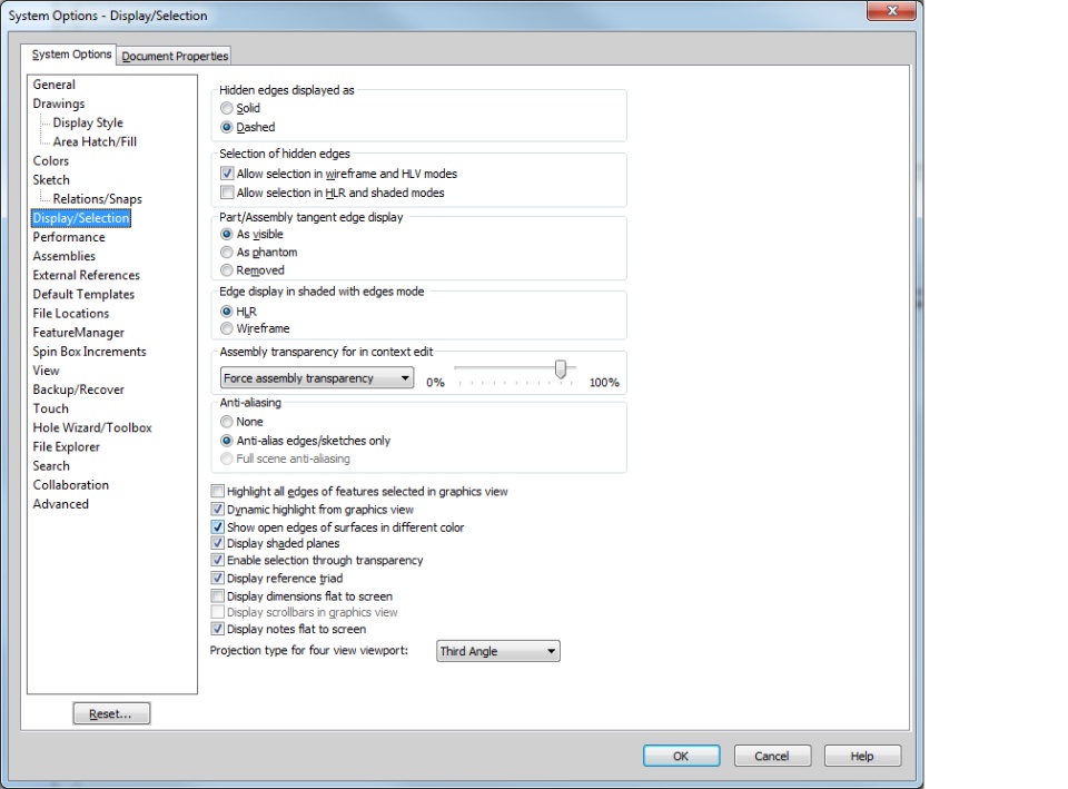

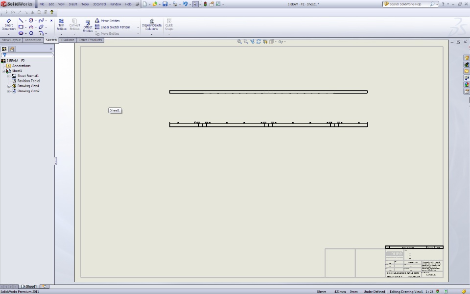

A colleague is having a problem with view creation on a drawing. Solidworks 2011 sp0. Upon creation of the drawing, he drags the front view to the drawing sheet, and then moves the cursor up for the top view, and is getting the bottom view, or the First angle view. Options are set for Third Angle projection. See attached. Any ideas?

Mike - easy mistake to make.  You've set the 4-viewport setting to third angle, not your Drawings properties.  Have a look at your Sheet Properties in your drawing (RMB/ Sheet Properties) - what you need is at the top in the middle.  Change your Template, etc to reflect this...

The settings you have shown aren't actually for the drawing views. That setting is for the viewports in the modeling graphics area (although, now that I think about it, it would be nice if they were linked).  The option you're looking for is in the sheet properties of the drawing:
Right-click on any empty part of the sheet (or the top-level drawing name in the FM tree), go to Properties.  There should be an option there for projection convention, and I bet you anything this is currently set to First Angle.
