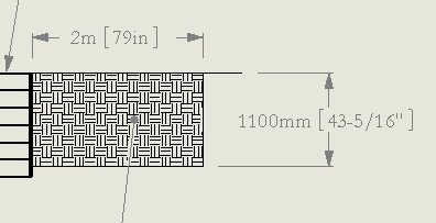

Most of my drawings are feet and inches, but I am working on one now that is set to millimeters, and in Options > Document Properties > Dimensions I have the boxes checked for Dual dimensions display and Show units for dual display.  Everything is fine until I go to Other, Override Units, and change from millimeters to meters on some of my dimensions.  When I do that the dual dimension call-out changes from " to in.  Any ideas?

What do you have set here in tools>options>document properties>dimensions?

It shows the double prime until I override an individual dimension from mm to m, then it changes to in.

I wish I had a quick answer for you.  Right now I am puzzled.
