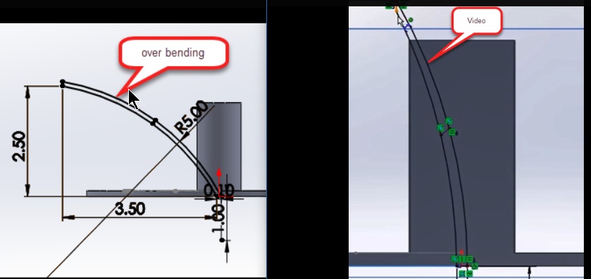

Even though my sketch dimension is same as in the video my sketch too much inclined to left side. What is the reason for that?

Over bends?

Not over bend too much inclined to left side.

i know but how you know for sure all the sketch relations are the same
its obvious that the curve on both images are not the same - I guess you might mistake radius with diameter

looks like a tangent relation, bottom right in video picture, this would start the line arc vertical.

If I change 3.5 to 0.6, I can get a sketch that is similar to in the video.

So 3.5 might be a center point ???

3.5 is not a center point.
