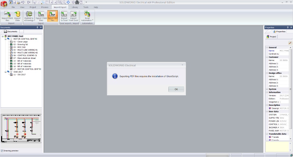

The problem starts with S-071644 which removed the PDFCreator from the Electrical setup.
If you want to enable it again you will have to complete two tasks after installing the pdfcreator manually.
1. Copy all files from C:\Program Files\SOLIDWORKS Corp\SOLIDWORKS Electrical\GhostScript\bin
to C:\Program Files\SOLIDWORKS Corp\SOLIDWORKS Electrical\GhostScript (one directory up)
Electrical is searching for them in the wrong directory.
2. Change HKEY_LOCAL_MACHINE\SOFTWARE\Trace Software\SolidWorks Electrical\Services\PDFPrinterName from TsPs to PDFCreator
If you restart Electrical, the PDF Export should work again. (You still have to install the PDFCreator as described in the Solution)

Hi i am hoping one of you chaps can help me please?
I am new to using solidworks electrical 2016 and PDM
i can not check in new projects that i have created, nor export/pint to PDF as i get an error message saying PDFCreator software not installed. When checking in this will crash the program and i have to restart it.
i can print an already created project (previously done on electrical 2014) but i can only print one drawing at a time to one PDF, eg i will end up with 122 pdf's in a project, instead of 1 pdf with 122 pages.

Hi, please do as the 3rd step in Michael Frose’s reply, and make sure the folder does exist.
