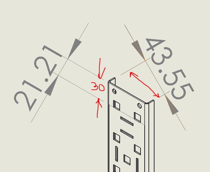

In solidworks 2016 drawincg how do i put a dimension in a ISO view which is parallel to edge?

JY 2017-11-17 Best Answer
select true under dimension type
select the parallel edges?
this should give you a parallel dimension??

Jason,
I'm using SWX 2017 so maybe it's different but when you say select true under dimension type, where do I do that?
EDIT:
Never mind! Found it!

So... are you going to share that information?
JY
JY 2017-11-17
its in the properties menu of the drawing view glenn.
I assume you already knew that but want that information to show up in this thread??

@glenn schroeder
Select you ISO view in drawing and then on left on property manager section you get the option. see attached

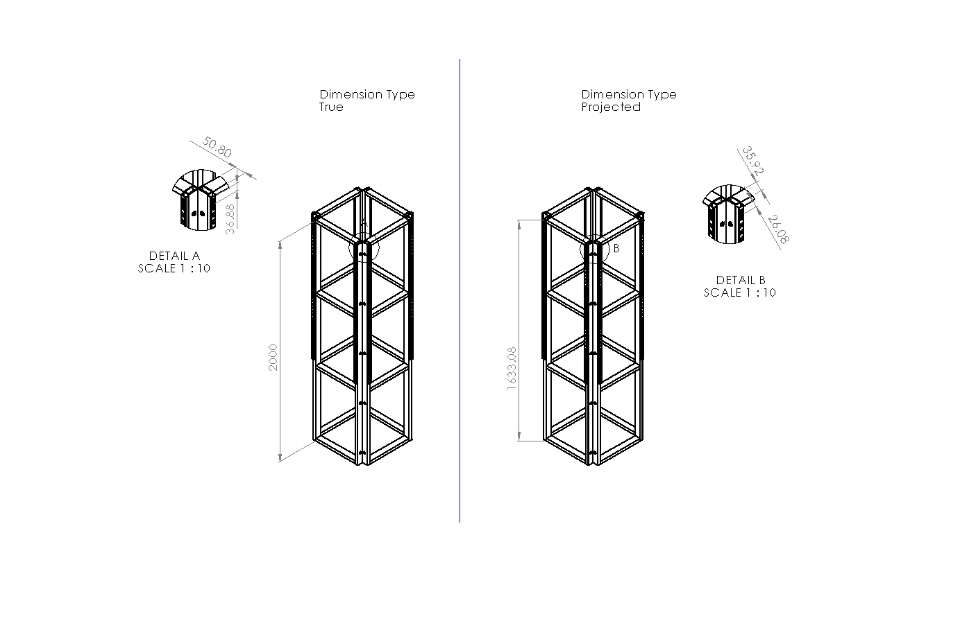

Projected comes in handy for situations like this:
If I wanted to dimension the height in the Right View, I would want the projected (4.000) dimension to show instead of the true (6.354) dimension.

but is that an isometric view???
looks like Plan & elevation??
AB
AB 2017-11-17
No, it's not an Isometric view, but our drawings don't always show an Iso view. And even if the drawing does have an Iso view, it's rare that we dimension it - it's usually only shown to give an overall view as to what the part looks like. Because of this, it's actually pretty rare that we use True dimensions - we almost always use Projected.

it just looks wrong to me, I guess it will be a case of its what you are used to.
from my point of view, it is the wrong information as both the length of the side and the distance between the 2 edges cannot be the same??

<p>Jason Young wrote:</p><p></p><p style="min-height: 8pt; padding: 0px;">...it is the wrong information as both the length of the side and the distance between the 2 edges cannot be the same??</p>
You're right, they wouldn't be the same. Projected dimensions measure the parallel distance between two entities, or the distance as shown flattened to the view. True dimensions show the "true" distance between the two entities that you select, regardless of view orientation.
If our shop saw this dimension on a drawing view:
they would understand it as meaning this:
Assuming everything was scaled and printed correctly, and if you used Projected dimensions, you could hypothetically measure the physical length of a dimension on a printed drawing and multiply that by the scale to get the real-life dimension.

What would be considered the "correct" dimension?
In this picture, I would consider the Projected dimension to be the correct one because I would understand this dimension to mean "the parallel distance between the top surface and bottom surface." I wouldn't be expecting this to show the literal distance between the two selected edges.

the perpendicular distance,
its just that in the original image it  showed the size across the corners as being the same as the perpendicular size. that confused the hell out of me.

Oh, it sounds like we're actually in agreement then - I would definitely want to show the perpendicular distance. In that first picture, I was just trying to show the difference between the Projected and True dimensions, I would never actually dimension a part that way.
Maybe this would've been a better way to show it:
