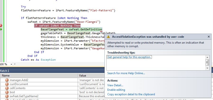

                    BaseFlangeFeat = swFeat.GetDefinition ---------this line bombs on config change

when I try to change configurations the line BaseFlangeFeat = swFeat.GetDefinition throws an exception
So, what is going on?  I *think* what is happening is SolidWorks is opening the underlying Excel table and taking write ownership of it, which makes the file 'write protected memory'.  Once this error occurs, solidworks starts doing all kinds of funny things.
So, how do I handle this?  I can't check to see if the gauge table is read only because I don't know what it is yet.  Any thoughts?
