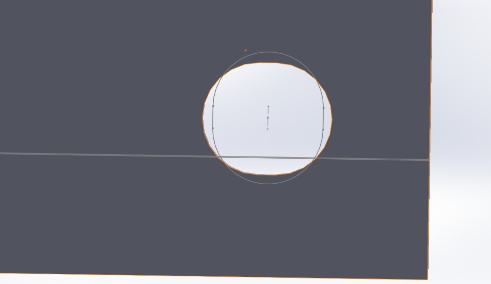

In hole wizard how do i turn a slot 90 degrees?
I can see how the slot is going to be inserted with preview in the hole wizard but i want to turn it 90 degrees.

Click on the centerline and choose 'Horizontal' from the Add Relations menu.

There is a line that runs through the center of the slot.  Select that line and add a horizontal or vertical relation depending on which way you want the slot to run.

Basicaly the angle of that centerline is the angle of the slot.  The hole wizard is just a fancy interface for a sketch.  Add an angle dimension to the centerline exactly as you would with any other sketch.
