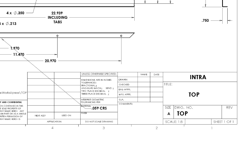

Is there any way to link mat'l thickness of sheet metal part without
creating custom property.
If possible I do not have to worry to change dwg after changing thickness
of sheet metal part.
Thanks

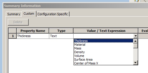

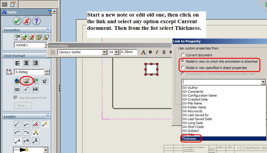

Best will be to use the custom property and linked it to the note in the drawing. And the value in drawing will automatically change if you do any changes in the part thickness.

DG
DG 2010-03-19
You need to create one. Go to custom property and give a name say Thickness and in the Valve/Expression, you can scroll the list to select thickness. Now in drawing you should be able to see this property.

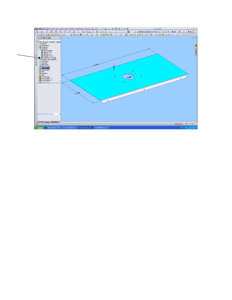

SF 2010-03-19
I think I did not expalin well enough.
Look at screen shot.
Right from feature can I link that .059" thikness ?
Or if I creat one how it will change in dwg. by itself if
I change from .059" to .075" or etc.
Thank you

MD
MD 2010-03-19
On your part property edit the list and add "Thickness"
in the Value/Text Expression select Thickness@Sheet-Metal1
In your drawing file link a note to "Thickness"
This will updateany time you change the thickness
Michael

DG
DG 2010-03-19
You need to link the note in the drawing to that property. Look at the pic.
