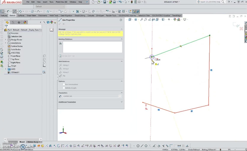

In a 3D sketch, when creating continuous lines, is there a way to have the lines snap to the nearest orthogonal direction?
Is there a way to make lines snap to the nearest orthogonal direction see picture below. I want to draw lines Along X, along Y , along Z by SW inferring a direction when I get close (snap behavior)
SolidworksSketching
Answers 20
GS
GS 2018-01-23 Best Answer
It's difficult to get it to show up in a screenshot, but when placing lines in a 3d sketch, when it gets close you should get an icon beside your cursor that says XY (or whatever is appropriate).  If you'll click to place the line while that icon is showing it will place that relation.  This is all assuming you have the appropriate snaps turned on at Tools > Options > System Options > Sketch - Relations/Snaps.

See the attached video.
When you are placing the lines, create the 1st line and, before you click to place the 2nd line, RMB instead and select the orthogonal direction of your choice.  This changes the previously created line.  Then place the 2nd line, and before you click to place the 3rd line, RMB instead and select the orthogonal direction of your choice.  This changed the 2nd line, etc...

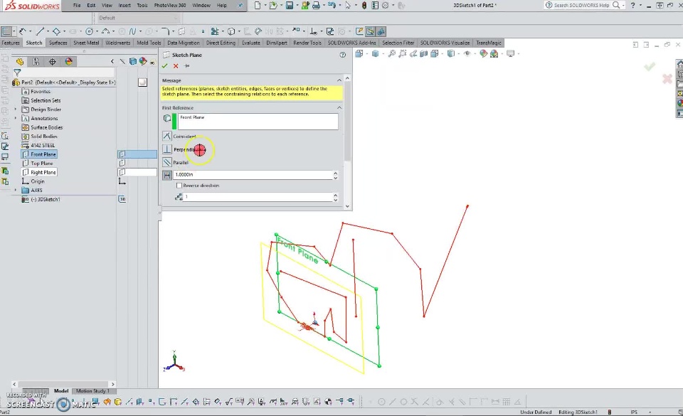

Are you aware of the Plane function for 3D Sketch?
This feature lets you simulate a temporary reference plane to draw on for your 3D sketch.  Basically, it mimics a 2D sketch while you have Plane turned on.
See the attached video  (mine is messy, but you can utilize it very easily to control 3D sketches)

No, I wasn't aware of this feature, it may help.
But then again, I don't know.
comment imagecomment image

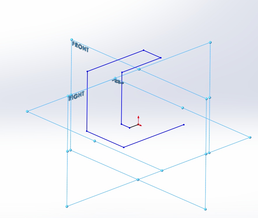

3D Sketches are my favorite and can be very powerful!
Are you using the TAB key when you're sketching in a 3D sketch? If you're not aware of what the TAB key does during the sketch it will toggle between X, Y and Z axis's and will allow you to snap to the axis you have toggled to.

Thank You Dennis, and all who responded. I use the 3D sketch in conjunction with sweep circular profile and combine subtract to create cooling lines in core, cavity,etc. I draw the rough path then drag it until it's close to what I need, then constrain it with dimensions/relations last. Dennis the TAB key suggestion seems to have done the trick. However I seem to have another issue. I put the line tool on the menu for the "S" key and it won't accept dbl click behavior (go into continuous line mode), but the line tool on the command manager works. Also if I inadvertently move away from the last intersection and move back the tool changes to arc, but if I move close to intersection and away again it doesn't turn back to line. Is there a trick to this as well? Alex Your idea works without a hitch except that it is tedious. I would also mark your answer as correct if I could mark two.
