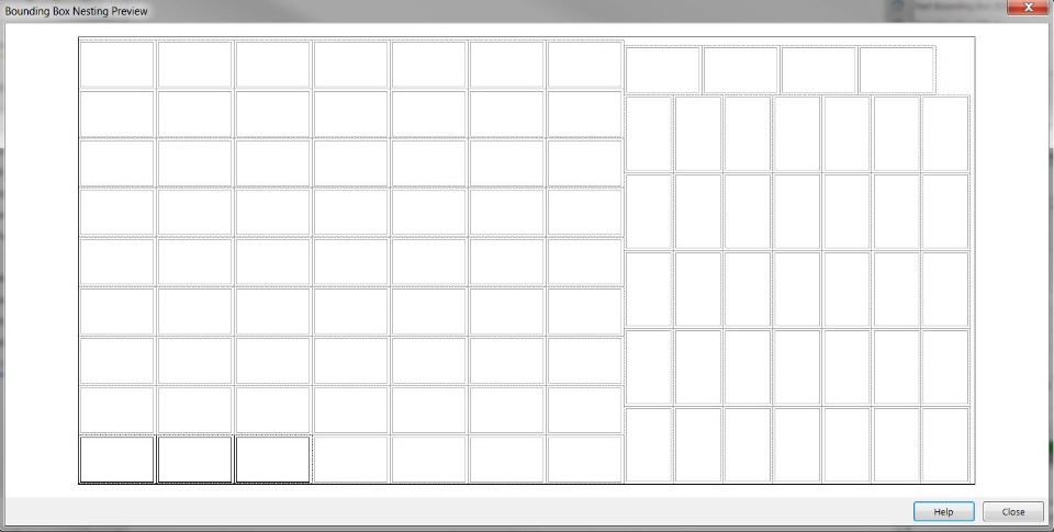

I am finding that Costing in 2016 is not much different than 2015. I have been saying SW should really look at nesting software to improve the costing functionality and they are at least exploring the idea, but its still far from usable. in 2016 when you an 3x5x8 inch piece of 14 Gauge SS with a single bend in it, you can at least see a nested sheet of 102 bent SM parts, when I only need 3. It would nice to load up several SM SW parts into some sort of Interface that are of the same Gauge and have SW nest each of them per the specified sheet data provided. As for the costing it can be broken out per total of each part or as a whole.

Thanks a lot for the feedback, I'm glad you are interested in the sheet metal bounding box nest functionality and I'm sure we can continue to expand on this as we get more input on the tool. Are you primarily interested in Costing for sheet metal parts? If this is the case, admittedly we have had more machining related enhancements in the last two releases due to its more complex nature, but you might have noticed that we have expanded the functionality a lot when it comes to castings, plastics, 3D printing, weldments, and assemblies so a lot of work was definitely put in to this tool.

No, I need to know about Cutting as well (utilizing a laser, & water jet mainly) for flat plate, & Structural members.
Nesting is something I spent 4 days this past month doing just to determine how many sheets of SS we need to build our entire machine. The only reason it took me 4 days is because we found some free nesting software. If I had to do manually in SW like I was doing it would have been more like weeks too figure it out.
