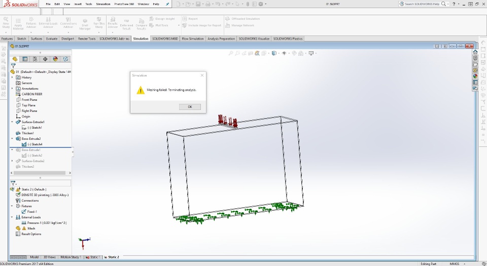

Hi,
with a thickness of 0.5mm analys ok , 0.3 ok and then 0.2 this :
it seems 0.28569mm is the lower limit without error so I don't really understand why; I ve tried to modifiy the part or the load force or material in order to see if it is that but it was not ????
Thanks by advance

Hi Eric,
The error message states that meshing has failed. Try to reduce the size of the mesh.
