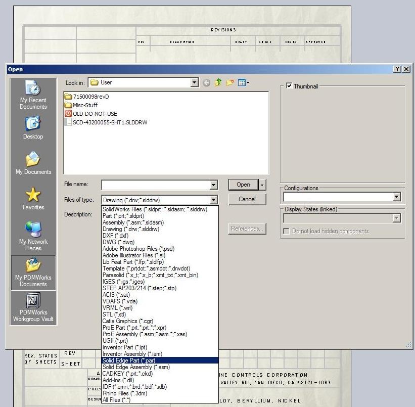

Not sure how ST would be translated, or even if it can be.Traditional imports as Parasolid data.
What happens when you select File, Open, SolidEdge Part?
See the screenshot below.

Hi Tim-
I can import the individual parts one at a time.
