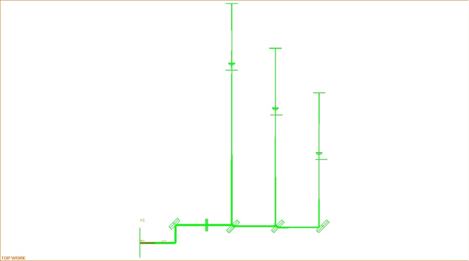

How do I get SW to import the optical line paths from Zemax or CODE V?
I can export out a STP or IGES but the optical paths don't follow.  However I can get this to work in Unigraphics.
The file should look like this but all I can get in SW is the optical elements.

Aric - I imported your assembly complete with the optical paths by changing my normal STEP-input settings as per the attached image.  I'm using SW2010 but I don't think these options have changed for a long time.

Hi Aric,
Use IGES and when you import it into SW, when you use the open file dialog for IGES, click the Option button make sure to checkmark the "Free point/curve entities check box.
Regards
